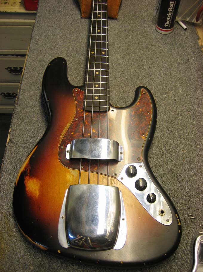

Here's a photo challenge! Is this bass the genuine vintage article or a
recently completed relic???

My guess is that is a fake. My reasoning goes as follows:
1. Why would you post this if it was genuine.
2. An instrument that has been played as much as this one seems to have been played wouldn't have the pickup guard. The only function of the pickup guard seem to be to get in the way.

I think I will have to say new. At least that fb and frets look to new or have just been replaced.
I think more pictures are in order. Can I buy a vowel please?

my gut says real
if the owner is like me, I still have original hubcaps
Hence the guard

Reminds me of my 62' strat with the rosewood fingerboard. I know that it's a fake cause all those little extra parts (bridge cover, wammy spring cover, etc were all long gone on mine and I know I would have taken that big bridge cover off and that other big ugly contraption over the strings would definately be gone.
PostPosted: Thu Jun 14, 2007 6:51 am
There doesn't appear to be enough scratching or wear in the pickguard to make this anything other than a relic. Not old enough for a real one, and more than likely most folks would keep their guitar from being so abused. I vote for relic.

It looks an awful lot like some reproduction Fenders I saw in a guitar shop recently. I vote for new.

Ok here goes.
I've been studying an early 60's Jazzmaster that's found an unfortunate
home at Guitar Center for every little finish detail I can find. I'd LOVE to
get the pics off my phone, but my phone doesn't connect to my
powerbook (talk about a first!).
The look and lack of scratches in the pickguard is identical to the bass in
the pic.
The look and condition of the fretboard is identical to the bass in the pic.
I haven't actually looked at the chrome much.
The discoloration in the plastic is identical to the bass in the pic.
The jazzmaster has its side dings, along with some major flaking in the
back.
I haven't looked at the frets of the jazzmaster.
So the ruling is.....
Jeff Senn (http://jeffsennguitars.com) makes the most believable replica
I've seen!
It's a relic. I've found that it's actually fairly easy to get the right lustre in
the finish....just buff by hand. But aging the pickguard?! And aging the
fretboard?!
I'm definitely using this bass as a model for the electric I'm working on
right now. The color is driving me crazy. I've already stripped the base
color once because I went JUST past the right shade. I'm considering
doing it again. I'll take a pic if I have time before class tonight. I'm
working on my last final of the summer right now

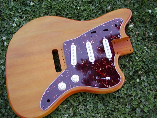

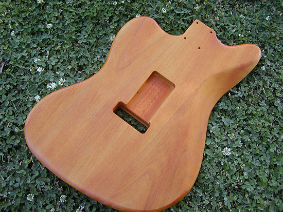

This is my psuedo-strat in progress. Two coats of color this time and I feel like I went right past the mark again. What do you think? Compared to the center of the bass above.

James, that looks really cool! Too hard to compare the color though with
such different lighting.
Did you make the pickguard?
